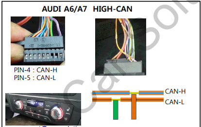

Can you see these CAN sons in these photos? thank you
CAN connection should be done behind the climate controlling unit as it's shown in the manual https://car-solutions.com/nfs/product/8 ... al_2.0.pdf , page 12.

ok, to summarize, if I plug the CAN link of the video interface to the CAN link of the AUDI? you do not need to connect the other wires of the power connector ....
except the + 12v power supply (red / black) ... true?
I found another more accessible place to connect the CAN link.
(nothing to disassemble)
I will post photos. (It can help other people)
picolo
Posts: 23
Joined: 19 Sep 2017, 18:20
Location: FRANCE
Car: Audi A6 C6
Re: difficulty to connections
Postby Yuretz » 02 Jan 2018, 10:19
True.
Postby picolo » 05 Jan 2018, 00:05
why the question ?
because, I connected to the CAN network of air conditioning, as noted in the manual, without success!
CAN interface cable H hs / ls, then CAN L hs / ls the same! no result !
it is obvious that there is a CAN communication problem on the Audi A6 Facelift!
(2010).
I am a little disappointed, to compensate, I used the +12 signal of reverse.
it is necessary to forget the controls of the vehicle to use the video interface !!

Postby Yuretz » 10 Jan 2018, 11:34
Have you tried all values in CAR MODEL after you've connected to CAN wires behind the air conditioning unit?
Postby picolo » 10 Jan 2018, 13:50
yes, everything tried, tried also to reverse the CAN cables (with some fear ... some cars do not like that!)
no dialogue!
no problem .... I will do with the "classic" way without CAN.
