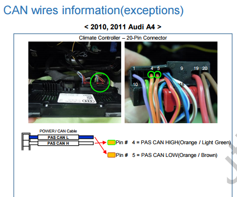

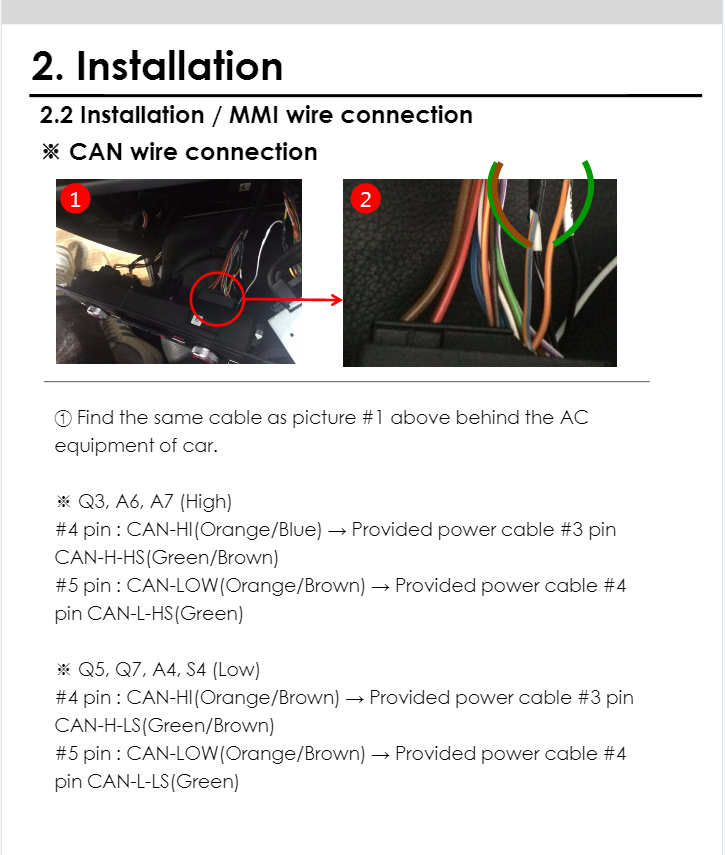

I've received my box, i was trying to wire it today, and I have a problem. I do not know where to connect HS-CAN wires. In my climatronic wires colors do not match to the manual. Can you help me?
HDMI connection works itself - i can connect computer but i have to switch it via external key.. which is not nice :)
There are pictures of my 20pins connector in climatronic. There are 4 other connectors in climatronic and only one has matching colors.
https://drive.google.com/file/d/0B3QwyM ... sp=sharing
Thanks in advance.

CAN wires may have different colors. It depends on many factors. Try wires which are indicated on the attached pictures. From 2V to 5V should be on CAN wires related to the GND.
