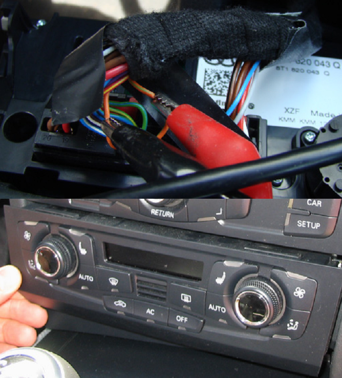

Postby Germes » 15 Jun 2010, 20:30
The CAN bus on the Air Conditioning console (under the CD player) is very easy to get out, and has more data than the CD player. The two arrows in the picture are CAN-HIGH (wire: Orange-Green, RED pick), and CAN-LOW (Orange-BROWN, BLACK pick).

Postby Stanley » 21 Oct 2010, 19:00
Is it possible just not tu connect those cables?
If yes, what functions may I loose?
