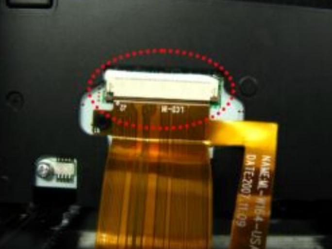

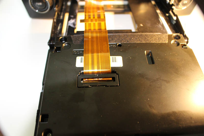

2. I have attached a photo from your instruction PDF.
Mine is connected exactly the same as this. I don't know how I can connect the cable the other way around because there is a narrower cable on the side that goes to the sub-board.

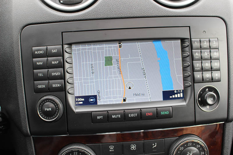

3. A clear photo of the front side of your head unit.

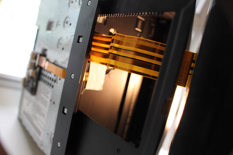

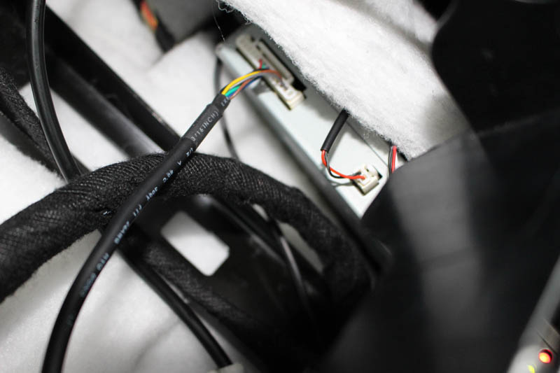

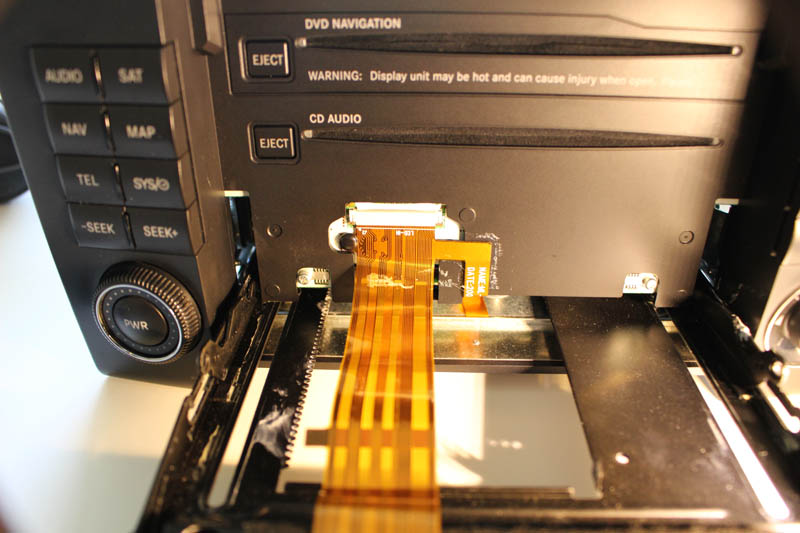

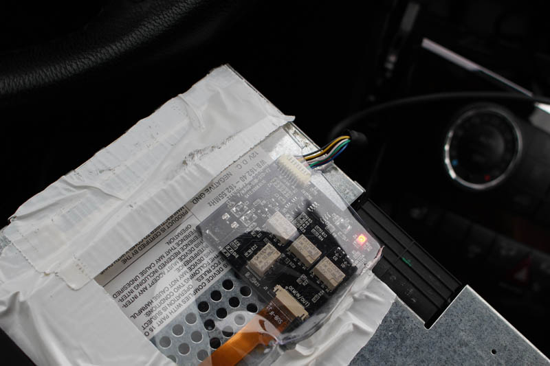

2. Please see attached photos of how everything is connected.

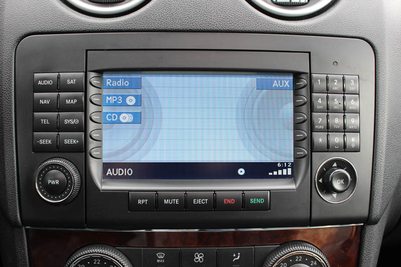

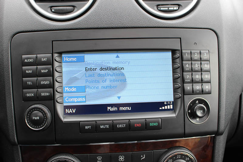

3. Please see attached photos of front side of my HU.
Thank you.

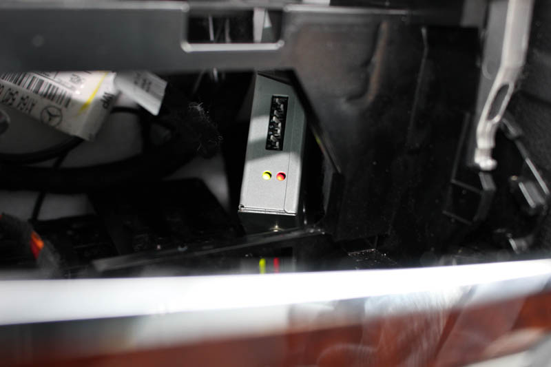

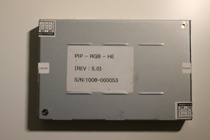

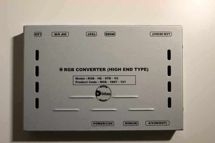

Thank you for photos. Could you also provide photos of the video interface from all sides to clarify the version of it. And have you tried the DIP switch #4 in OFF position?
Re: Video Interface for ML320CDI US model
Postby kaz » 31 May 2016, 08:12
Hi Yuretz,

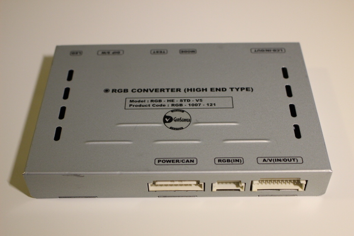

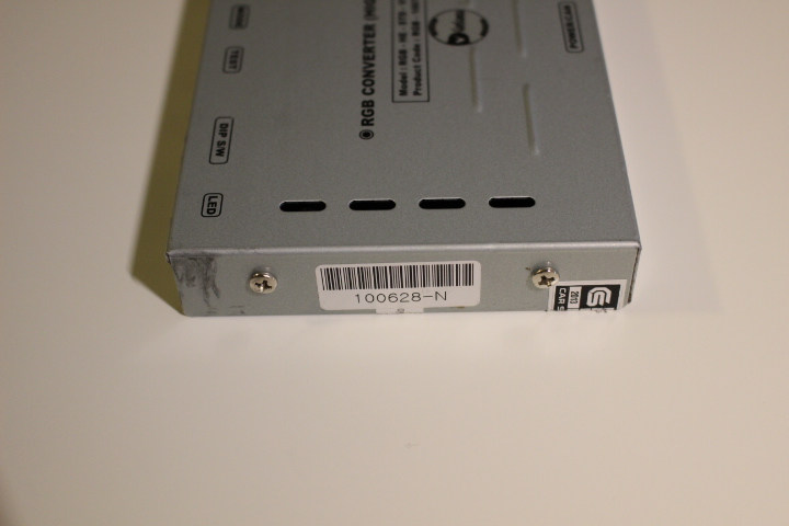

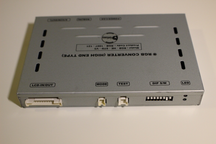

Please find attached photos of the video interface.

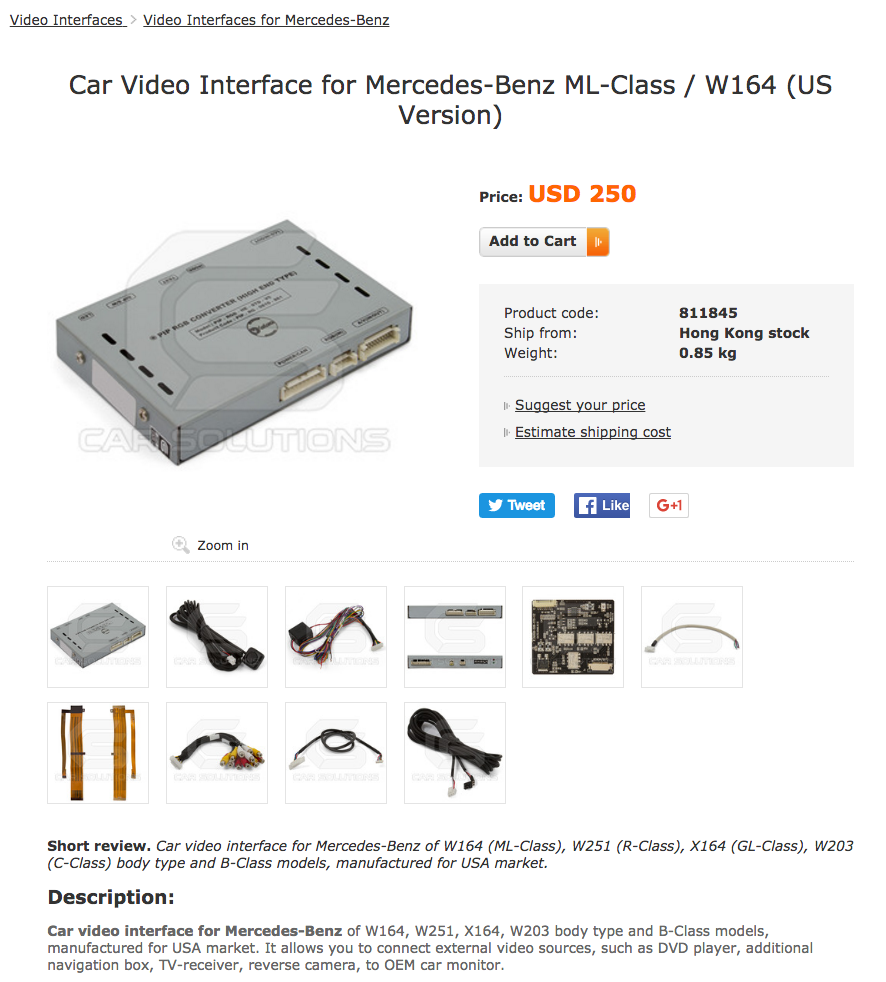

I disconnected the cables as they are already installed in the vehicle and it requires a lot of efforts to remove them. So please do not tell me to take photos of those.... The power cable was connected properly as you could see on my previous post. The items came within the package were exactly the same as the photo shown on your website. Please see this screenshot from your website.
Rear camera was connected to rear camera input with power provided from backup light power. And also, a video device was connected to AV1.
I have tried many different positions of DIP switches including #4 in off position. I actually searched a lot on the website and found that the interface I received was "High End Type" which is different from the one on the PDF manual on the particular page of your website. So I assumed that #4 was for AV3, instead of CAN-bus on/off for Cayenne.

Please contact our sales department http://car-solutions.com/en/information/contacts.html . We'll replace this set to another one based on RGB Low-End.
