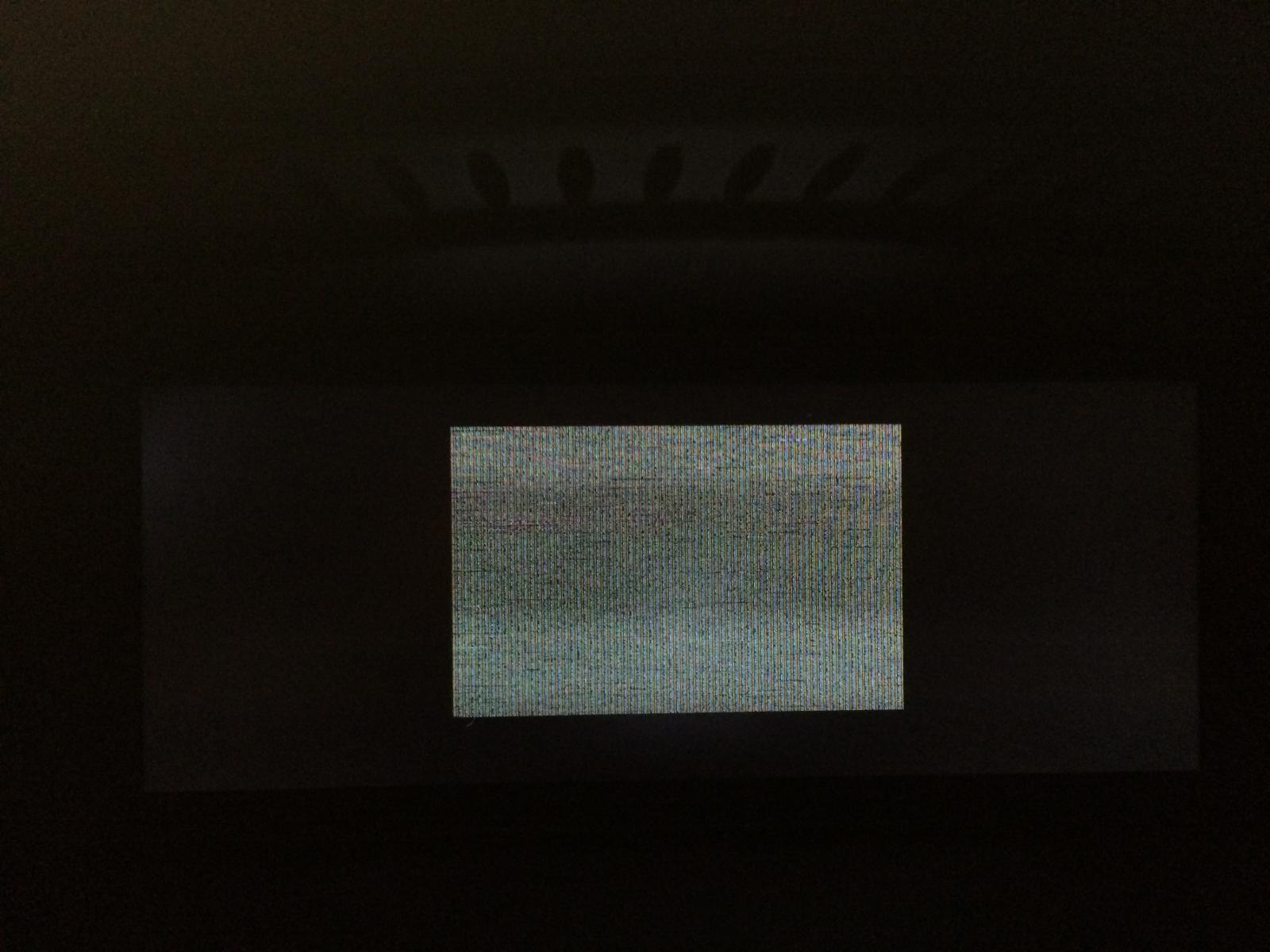

Postby Bob » 17 Oct 2015, 00:36
Hello,

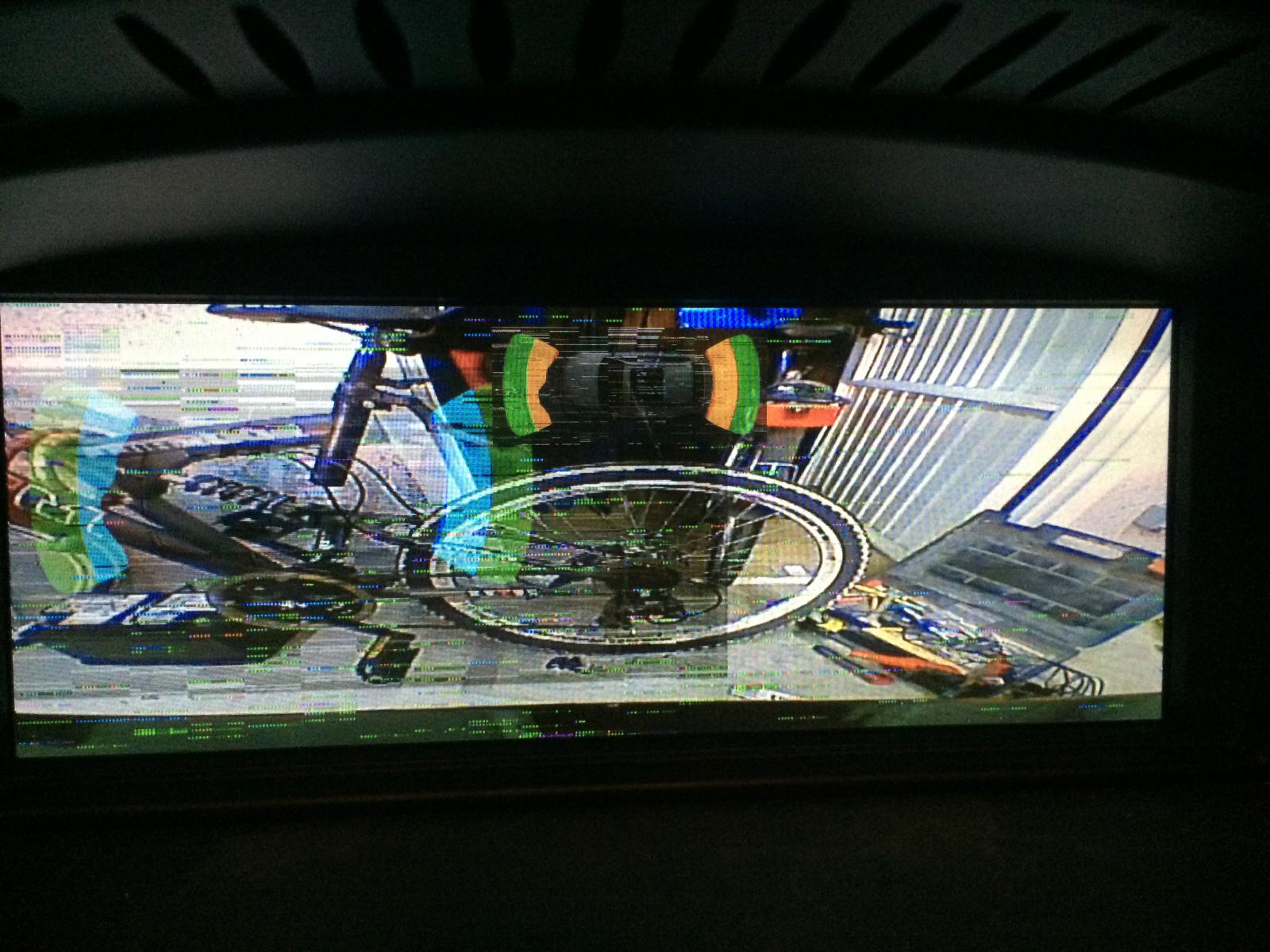

i have after installing the cam another problem. The picture of the interface is like the attached picture. It is not clear. I tried more then one video source on all AVs and REAR-Input. It is still the same.
what is the problem?
best regards

Postby Yuretz » 19 Oct 2015, 11:34
Bob wrote:Hello,
best regards
First of all try plugging in fully the connector which goes to the monitor suggested by milkancho.
Also, you may try resetting settings of the interface to default. To do this press and hold button "right" on the remote control for 5-6 seconds.
If the problem is still present then please describe how you powered an interface and additional devices up. Clear photos will be extremely helpful.

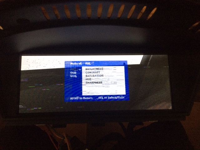

Postby Bob » 21 Oct 2015, 21:37
Hello again,

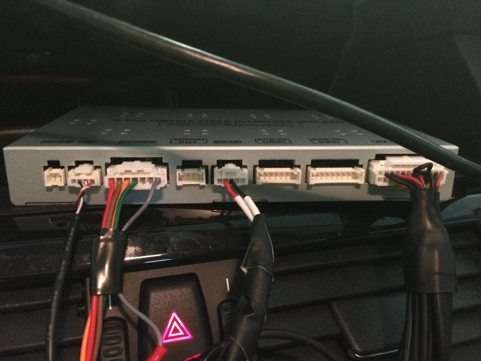

the Problem with the noisy Picture is still available. i try to explain how i am connecting the Interface, and which Problems i have with it.
here are some pictures i made today from my Display. the pictures are from different modes.
This Picture Shows how the cable are connected

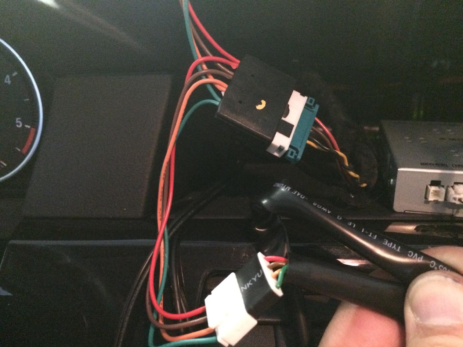

This Picture Shows how the enclosed connector is connected to the display

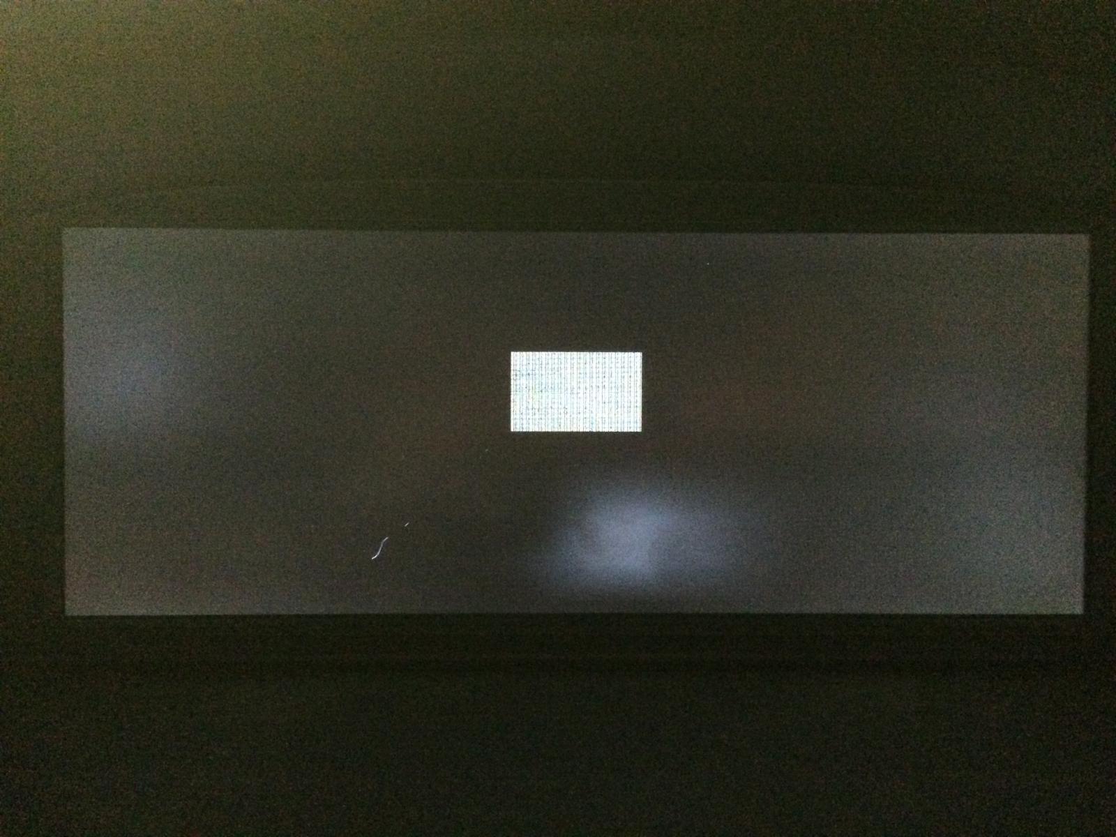

Here is AV1 running without videoinput, the text isn't readable
Here is AV1 running without videoinput, the menu also isn't readable

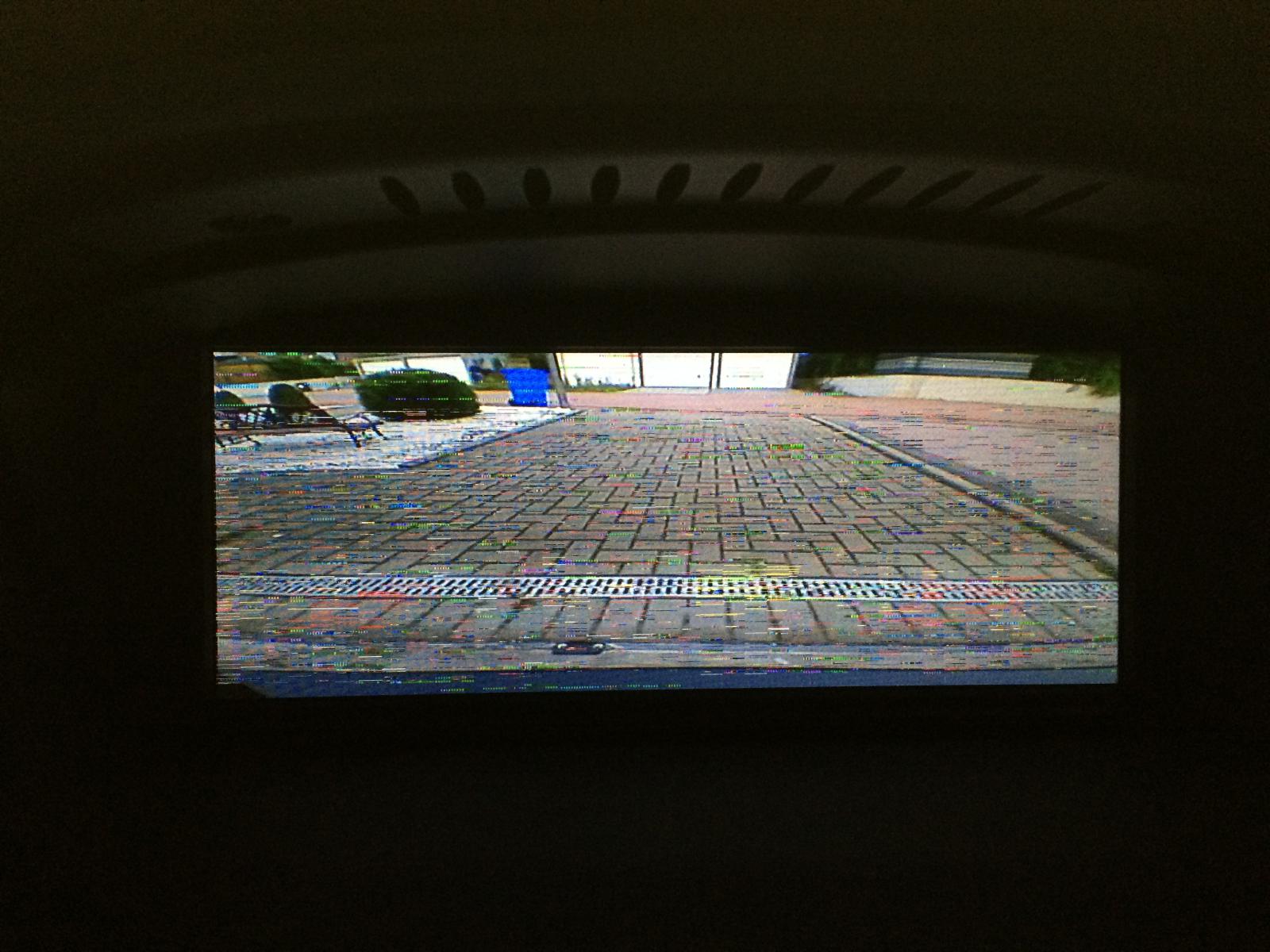

Here is the rearcam on, the Picture is too noisy

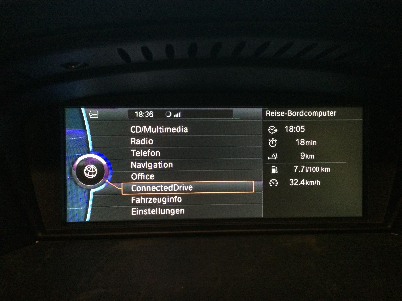

This is the normal menu of my car. normally there isn't any Problem. Some time like at this Picture, the Colors are distorted
Here is the rearcam on with pip of my PDC. if i turn on the guidlines is the Picture worser then this one.
Of Course i am doing the Suggestion of milkancho, but no improvement. Maybe the Interface is faulty? Please tell me what you think about that. If the Interface is faulty, how to Exchange.

Postby Yuretz » 22 Oct 2015, 09:43
Have you tried plugging in fully the round connector - http://car-solutions.com/nfs/product/85 ... nes-11.jpg ?
Also:
try resetting settings of the interface to default. To do this press and hold button "right" on the remote control for 5-6 seconds;
try DIP switches #5 and #8 in different positions(put toggle in another position only when the inteface is powered off);
Re: CAN doesn't work for E61 LCI 07/2009
Postby Bob » 22 Oct 2015, 20:57
Yes i did, but no changes. It's still the same result.
If switching #5 in other position i only get a black display, when switching to rearcam or AV1, AV2 or AV3. if switching #8 in other position no changes.
I am now sure that the interface is faulty. So please send me a new one.
