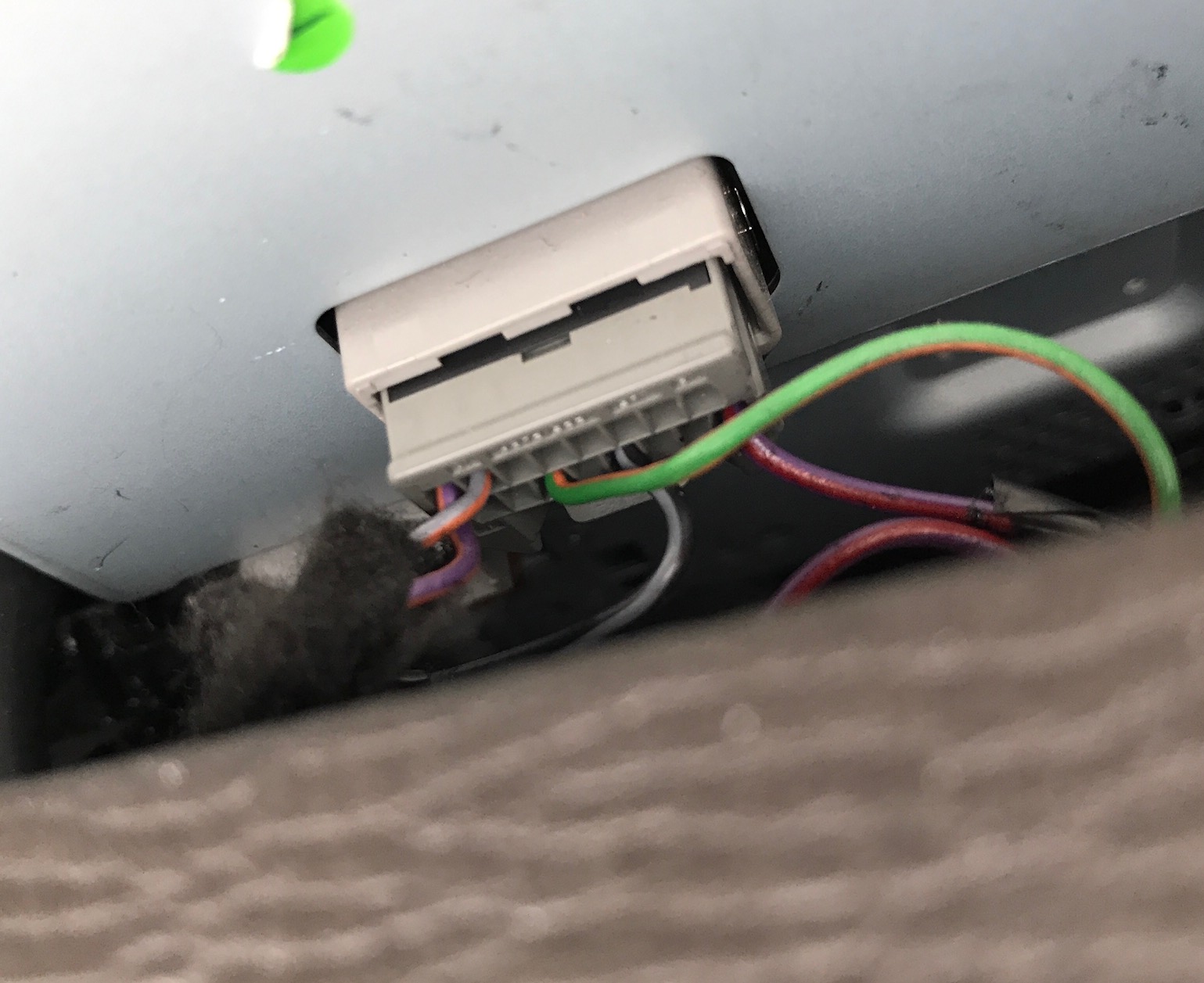

Postby jv1 » 24 Jul 2017, 17:24
Photo of the power is here. They're the same compared against the example in the manual.

Re: 2012 Volvo XC60 Interface Turning Off
Postby Yuretz » 25 Jul 2017, 10:35
Have you connected ACC, GND and CAN wires from the interface there?
Postby jv1 » 25 Jul 2017, 14:43
Yep, everything else is connected according to the manual.
