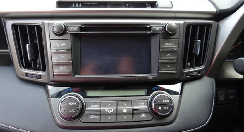

The next work will be a 2013 Rav4 with 53888 T&Go unit, but on this unit there is only a NAV button, not MAP/nav.
Will this set work with this unit?

Look on the reverse side of Universal Touch Adapter, there is a sticker with the firmware version and description of the witches. For RAV4 set the position ON (down) - the OEM NAV button will be activated. For Prius try it in both positions.
