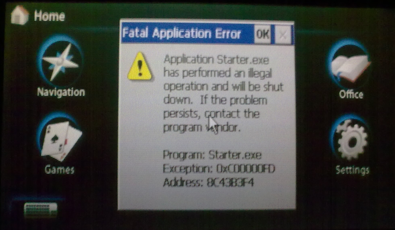

I have in my CS9100 one additional issue. During startup I got fatal error. Print screen is in attachment. If I will not tap the ok button then the GPS is not working. Do you have never version of Starter application?

Re: Clock reset
Postby Chortenia » 09 Apr 2013, 14:52
Hello!
Change COM1 for COM6 in the settings and try to adjust other settings.

Postby wildcat » 09 Apr 2013, 17:45
I have COM2 chosen for GPS and this is valid port. If I change for any other number, I cannot establish communication with GPS module.
Nevertheless for every port setting I have such fatal error at the beginning. After tapping ok button everything come back to normal.
What Starter application do, beside starting the menu and navigation software?

Re: Clock reset
Postby Chortenia » 10 Apr 2013, 14:27
Starter utility is in ccharge for the autorun, but it remained in the testing stage. Unfortunately, there are no new versions.
