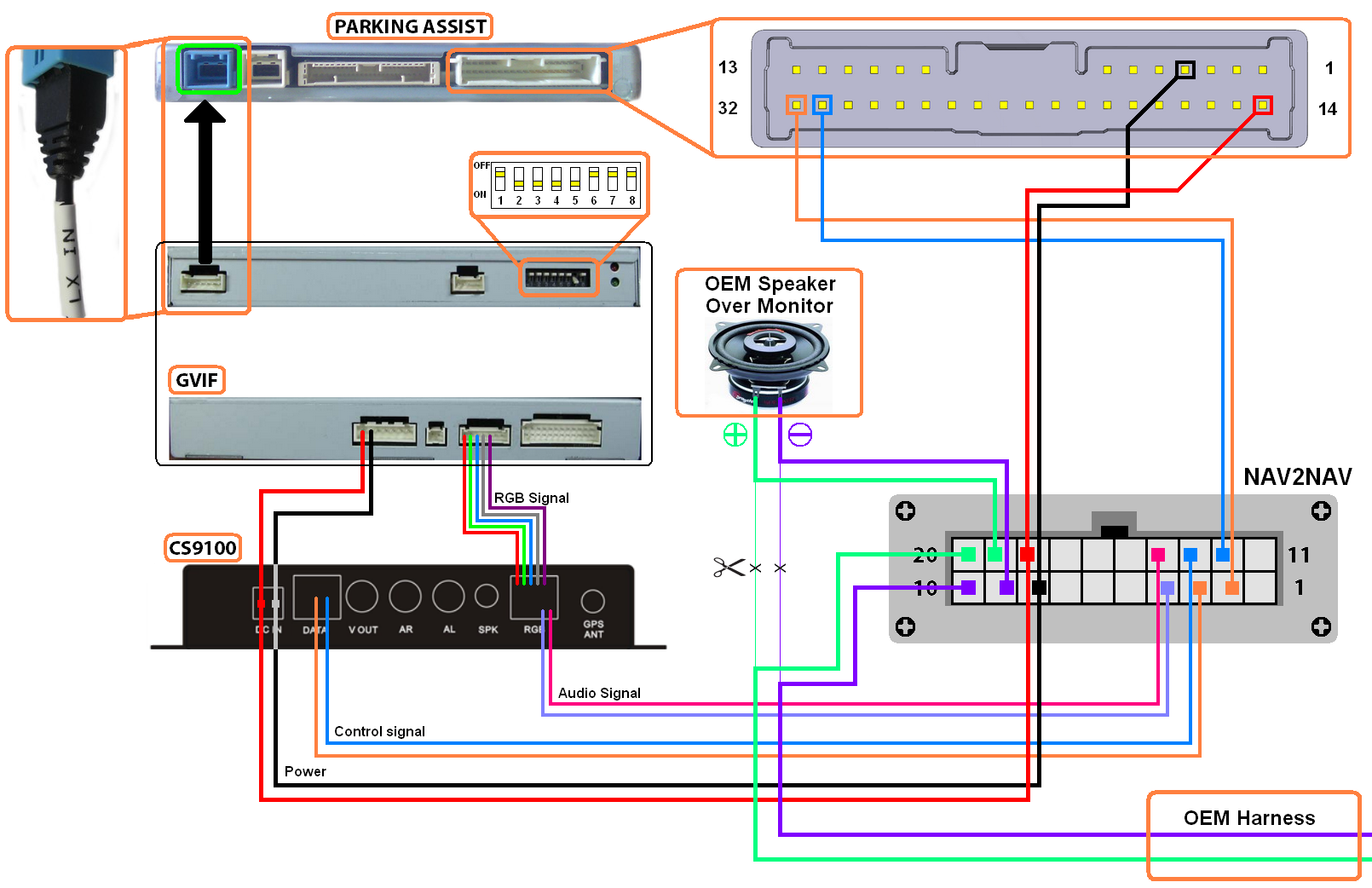

Hello
I tried installing CS9200RV Lexus LX570 2011 with interface GVIF a problem wire No. 12 & 13 empty and there is no wire
Note that the car Lexus LX570 Year 2011 version GCC without Hardsk
Attachments Photos for navigation box - back screen and conductor.
Please give me me how it be connected.
Photos : http://www.gulfup.com/?ItUgCX
Thank you

Here is schematics for Your case:

Re: CS9200RV Lexus LX570 2011
Postby snnar » 14 Jan 2013, 02:23
Hello
CS9200 installed such as in the diagram
I could not activate the navigation by clicking on the audio key twice
How to activate on-display navigation
Car for Lexus LX570 2011 GCC without Hardsk
Thank you
Postby Chortenia » 14 Jan 2013, 12:33
Hello!
Navigation is activated by MAP or DEST button.
Postby snnar » 14 Jan 2013, 14:40
Hello
Navigation is not activating all the buttons
Do I remove original navigation system?
Is there a complete guide for installation
Thank you
Postby Chortenia » 14 Jan 2013, 16:00
Try to switch by remote control or OSD keypad, whatever was in your package content.
Check all connections once more according the manual.
You don’t need to remove OEM navi.
Please, also provide the photo of DIP switches position.
Postby snnar » 14 Jan 2013, 18:55
hi
switches for GVIF 2-3-4-5 on
switches for nav 3-5 on
snnar
Postby Chortenia » 15 Jan 2013, 10:49
Hello!
Set switch #3 on the UTA adapter in OFF position. If it doesn’t help, please, provide video where we can clearly see where the cables are going, marking of the cables, places of connection and what is displayed on the screen when you press buttons.
