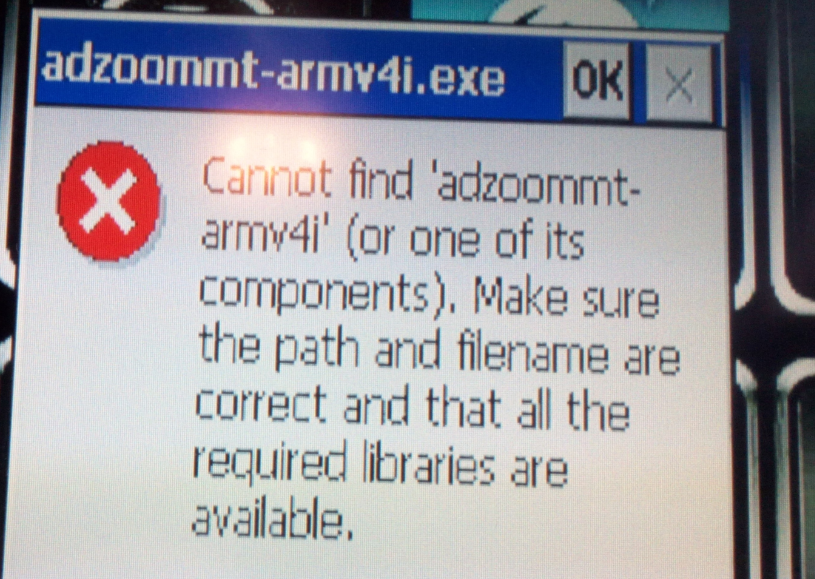

Hi when I press the IE button I get this error
also is there a way of changing the screen icon colours and background
Thanks

Copy content of
this archive on the memory card and rename opera-mini.exe to adzoommt-armv4i.exe.
It's impossible to change the colour of the background and the icon.

I tried to do as you say in renaming opera to adzoommt-armv4i.exe but when you select IE button I still get the same error message please help
Unpack this archive to the root of the SD card and run via IE icon.

Thanks this worked
