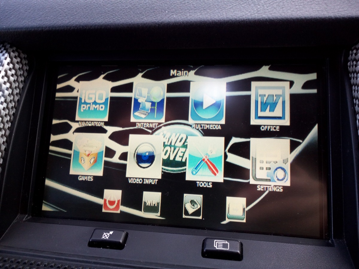

I have purchased a wifi dongle and loaded the driver however when i click on the wifi button nothing happens it just lights up blue and does nothing Please Help

Unfortunately, the system doesn't have drivers for dongles on such chipset. Only Wi-Fi sticks on VIA vnt9271 chipset are supported.

Got it working you need driver rt2870.dll
