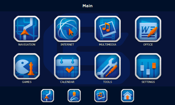

Postby snnar » 08 Dec 2012, 12:25
Hello
I have a blue menu in English
How to install and activate Instead of the current menu black
Thank you

Postby Chortenia » 10 Dec 2012, 11:41
Set the following to autorun: System->Auto Run Navi ON, select Navi path: SDMMC Disk/Menu/Menu.exe
