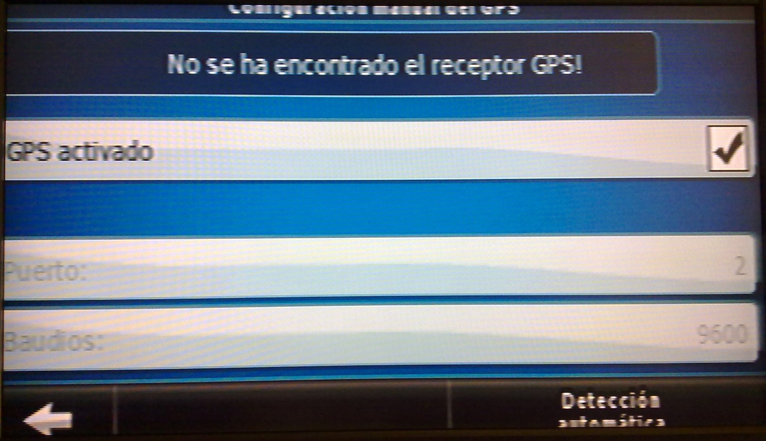

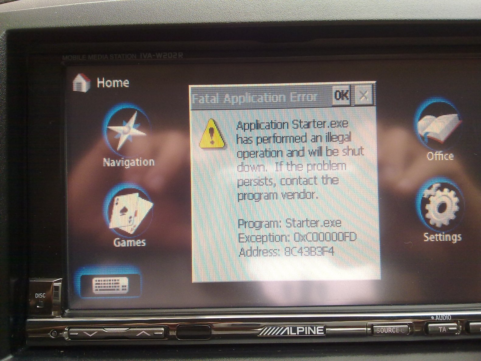

I try to Install GPS BOX CS-9100 in Hyundai Sonata del 2007, Alpine IVA-W202R with a special cable Alpine Cable AP-RGB1 for Navigation Box CS9100RV. GPS was working correctly for 3 days, and then stopped recognizing GPS Antena.
here I send you pictures of the error I get

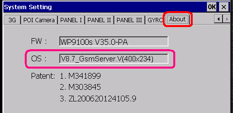

WARNING: that procedure only for navigation unit CS9100 with OS version:
a) V8.7_GsmServer.V(400x234)
b) V8.7_GsmServer.V(480x234)

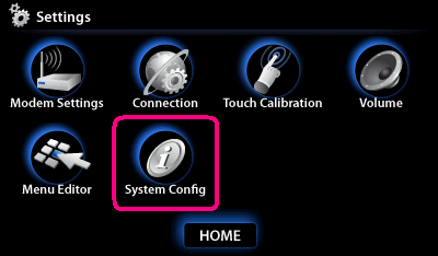

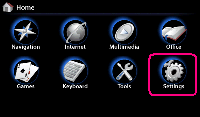

How to know OS version:
1.
2.
3.
