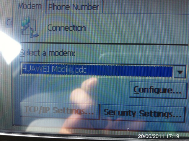

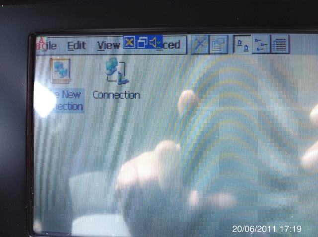

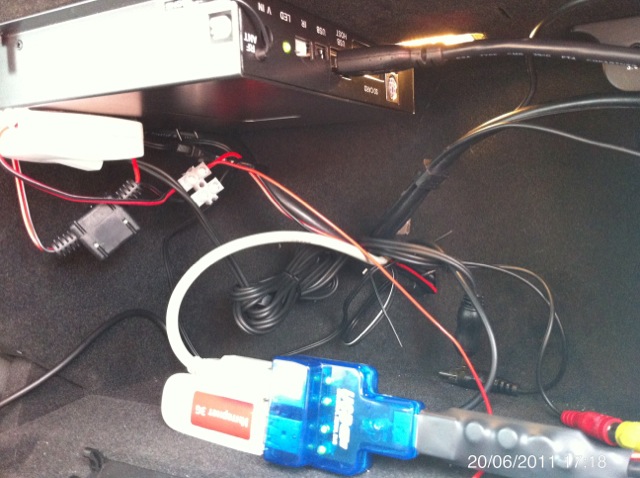

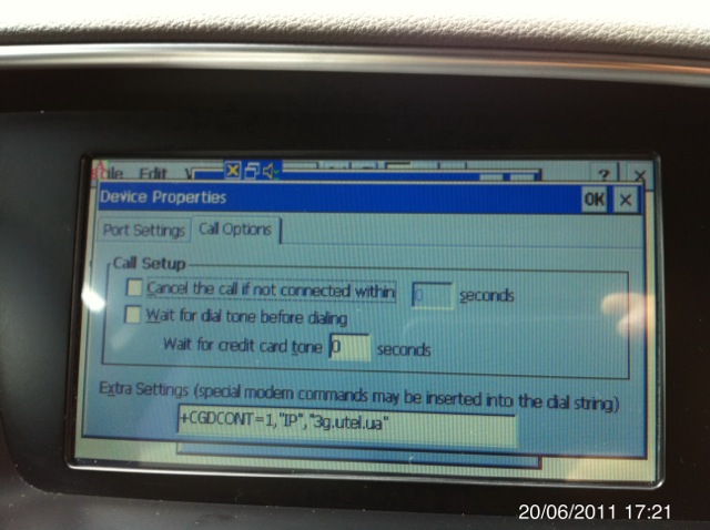

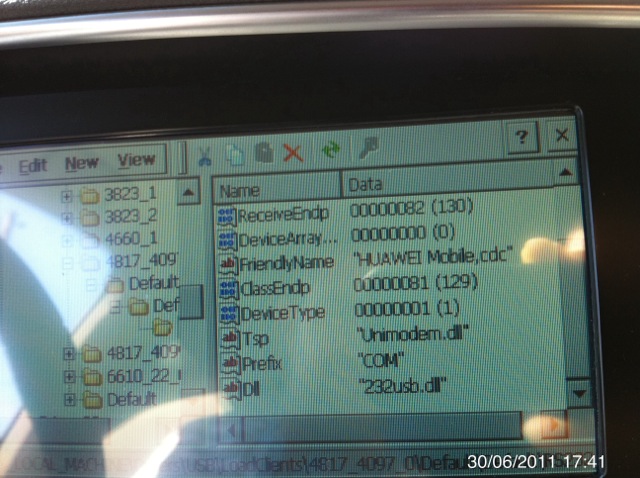

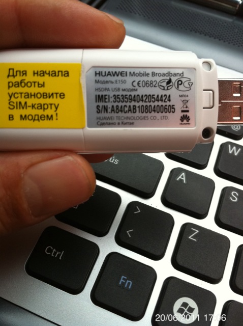

Hello!

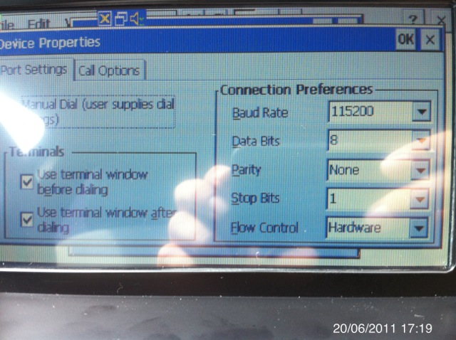

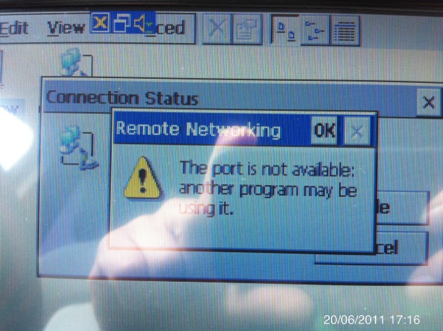

I bought a modem from you and connect it with CS9100.
Please check the pictures which error I get:

I tried to change PORT from 1 to 11, but still does not work. Here I send more pictures

Re: Huawei E150 Install for CS9100
Postby Germes » 06 Jul 2011, 18:30
1. Copy to SD card this file - E150_Install for CS9100.exe
E150_Install for CS9100.zip
(10.85 KiB) Downloaded 2308 times
2. Run E150_Install for CS9100.exe
3. Restart CS9100
4. Create new connection
CS9100_Modem_connection_v1.1_EN.pdf
(60.44 KiB) Downloaded 2971 times
5. Enjoy!
