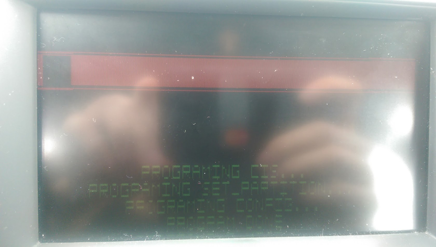

Hello, here is what happened.
1. I've copied the files from the archive from the first link on a blank SD card. Insert in the device and start it. Then it starts to flash the ROM but it stop on the 4th line "Program Done". I've wait for a more then 10 minutes and then I decide to insert the other card with the update.zip file. I shut down the device, take the card out and put the other one in and when I start it the resolution was messed up with the all other settings, so now I cant tell if I did it wright or not. I see something on the screen of the navi but dont know the flash was successful or not.

Postby Yuretz » 03 May 2017, 10:37
Ael wrote:Hello, here is what happened.
2. Then I decide to connect the box to external monitor through CVBS video port so I can fix the resolution. I've tried on 5 different TVs and Monitors and I cant see any video signal. I even ordered one Video to VGA converter so I can try on the computer screen but so far with no success.
So now I have one half flashed (maybe) android box witch I cant run on CVBS Monitor for some reason. At least is not Bootlooping now :lol:
What is the next think we can do so I can get this think to work again ?
Try updating with wp9920_update.zip once again. If the picture won't be seen after 5 minutes then, please contact our sales department https://car-solutions.com/en/information/contacts.html for replacement/repair .

Postby Ael » 04 May 2017, 14:43
Just tried with 4.3 and after that with 4.1. No picture at all on 2 TVs with different video cables. It updates for sure because the ZIP file is gone from the card right after I power up the device.
When I connect it with RGB adapter to the factory screen comes a picture but the resolution is wrong so I can not see what is on the screen.
