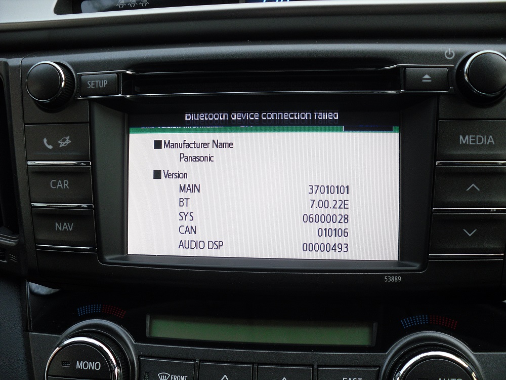

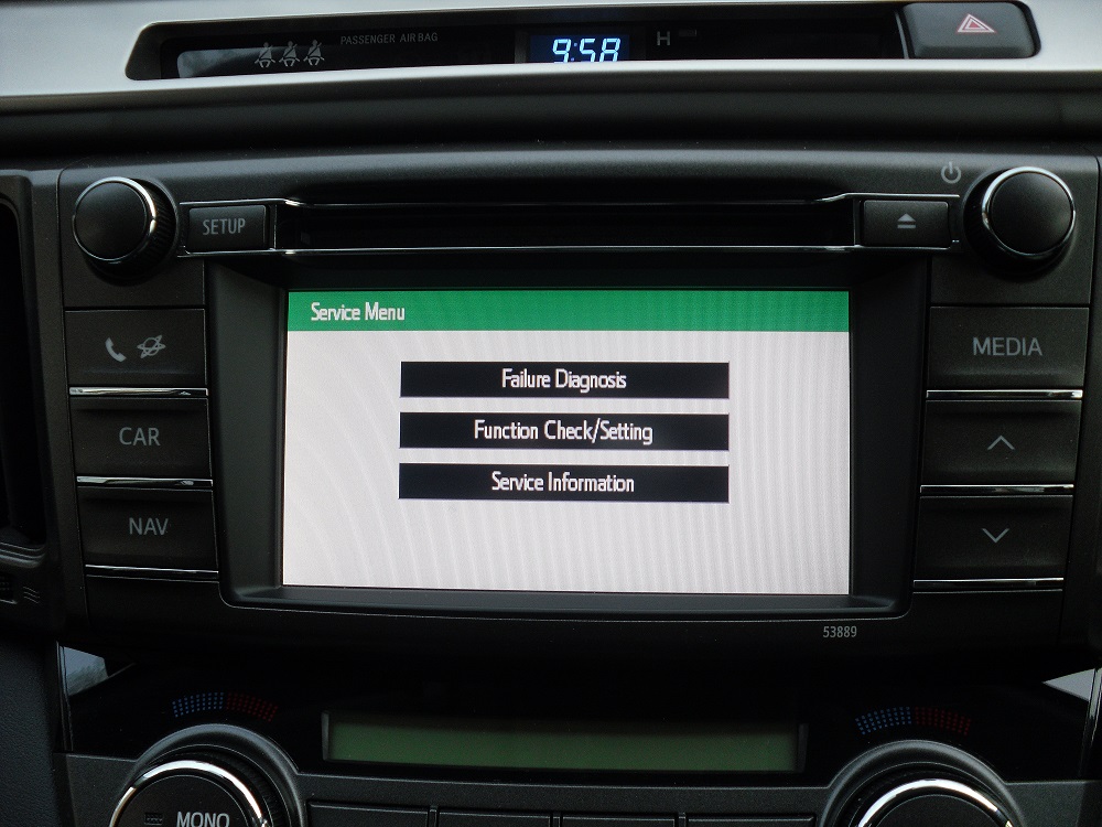

With the engine off but the keys in the ignition at position 1, press and hold the MEDIA button on the HUD, and then turn the lights on & off three times. This displays the SERVICE MENU.

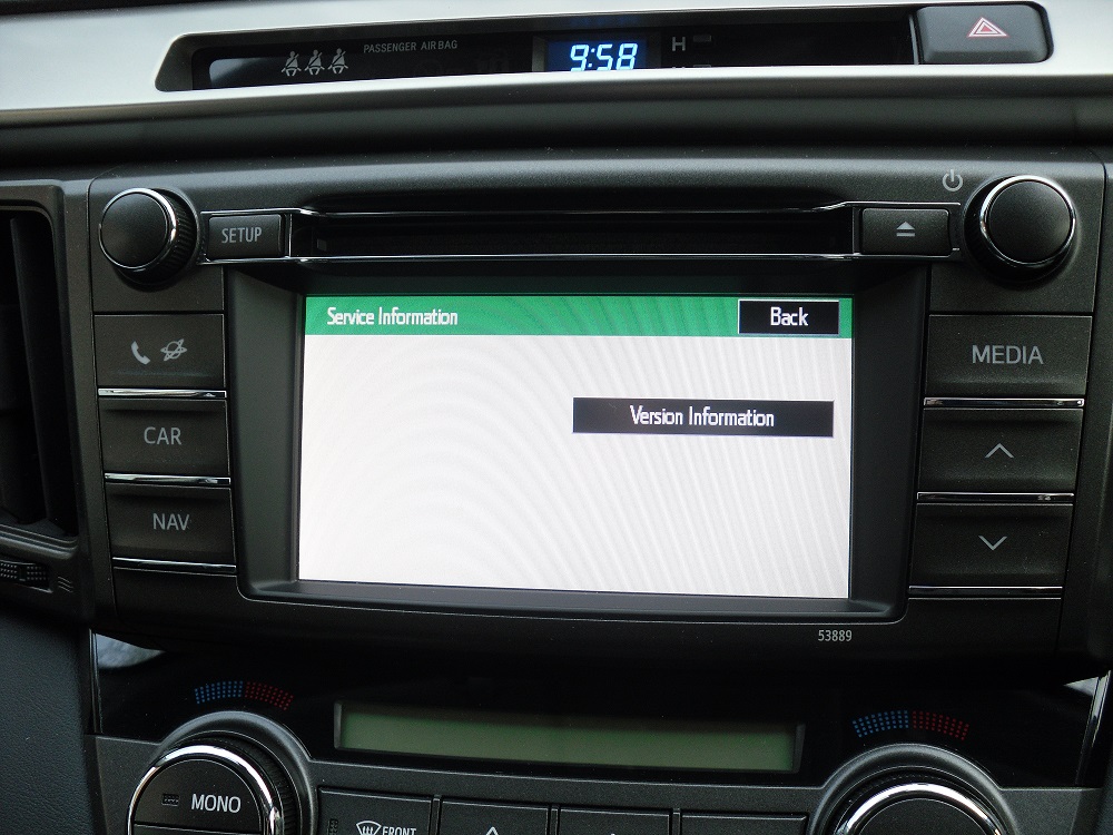

Next press the SERVICE INFORMATION option to display the SERVICE INFORMATION page.

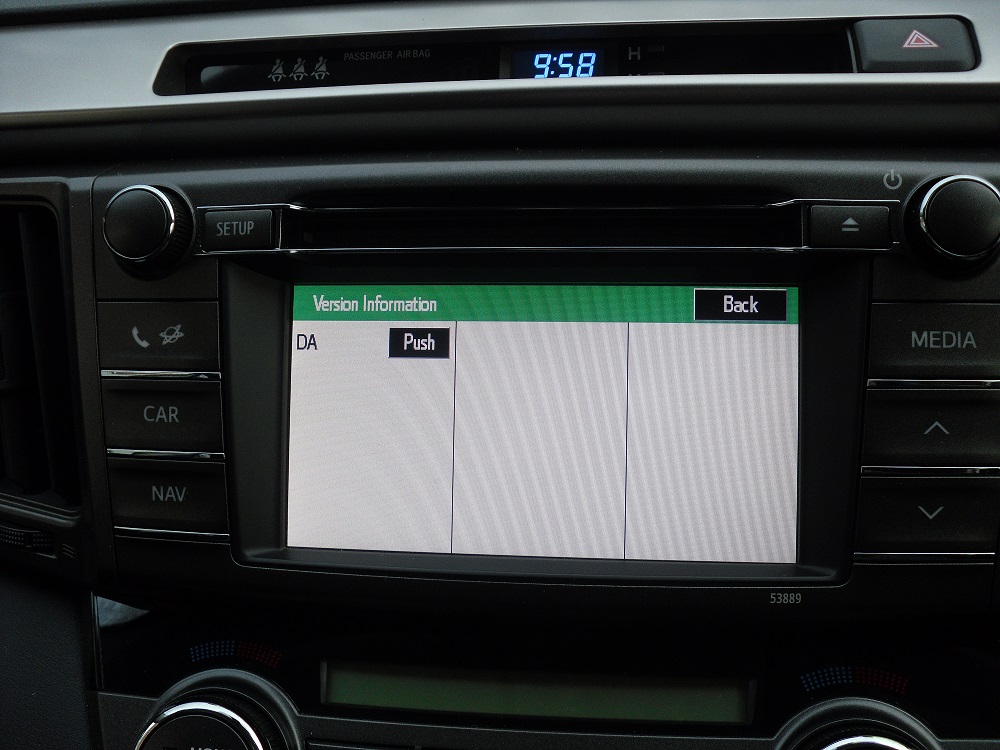

Then press the VERSION INFORMATION to display DA PUSH option.
Finally press the PUSH option to display the Manufacturer Name & version data.
Take a photo of the Manufacturer Name and send it to Gregory in sales [url]sales@car-solutions.com[/url] and he will advise the correct Interface components.

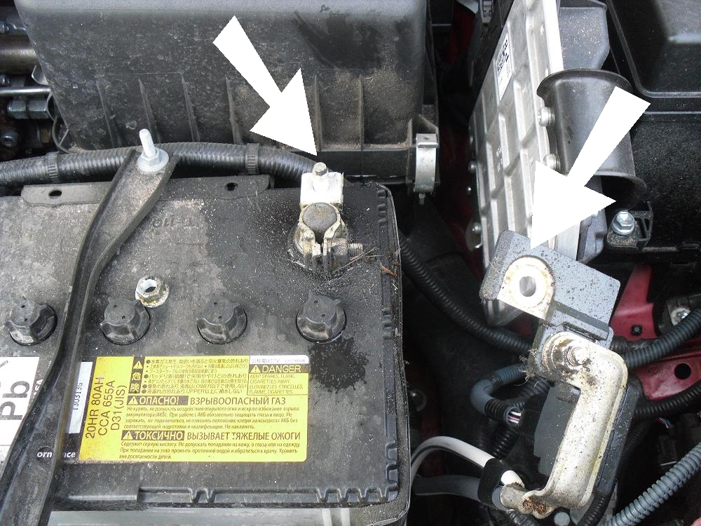

Remove the negative terminal from the battery making sure you have the car unlocked and the two front doors open.

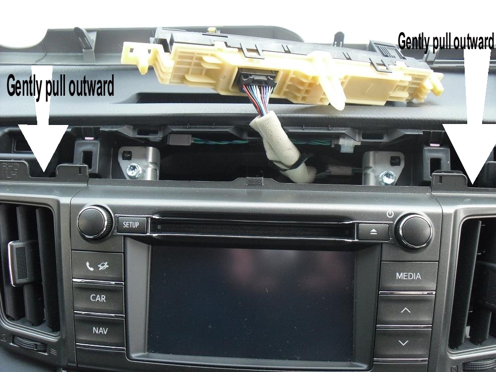

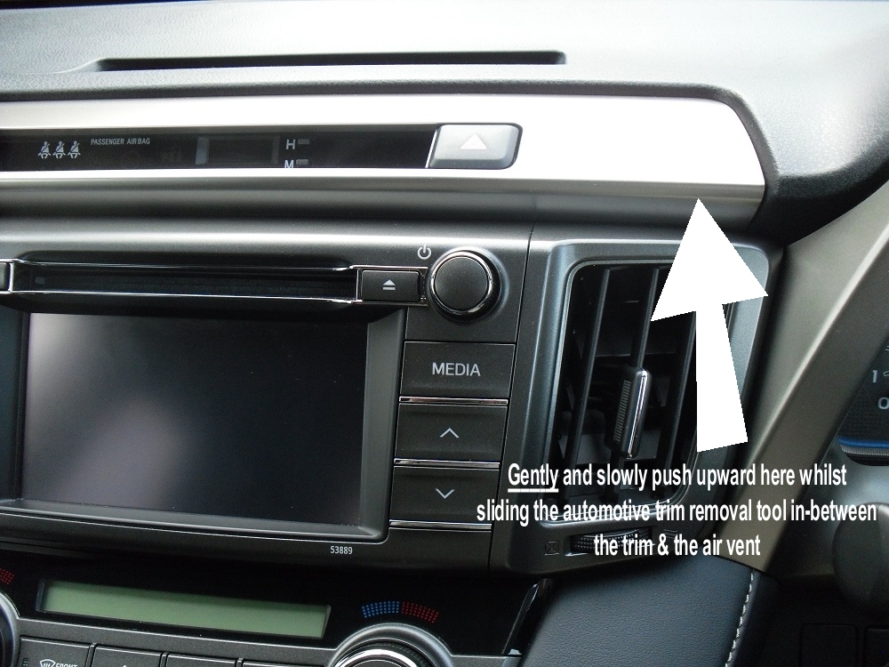

Using an automotive trim removal tool (or a wooden spatula) gently lever off the corner of the clock trim, slowly lifting out and upward. Once the corner is loose, gently pull along the length of the trim to remove.

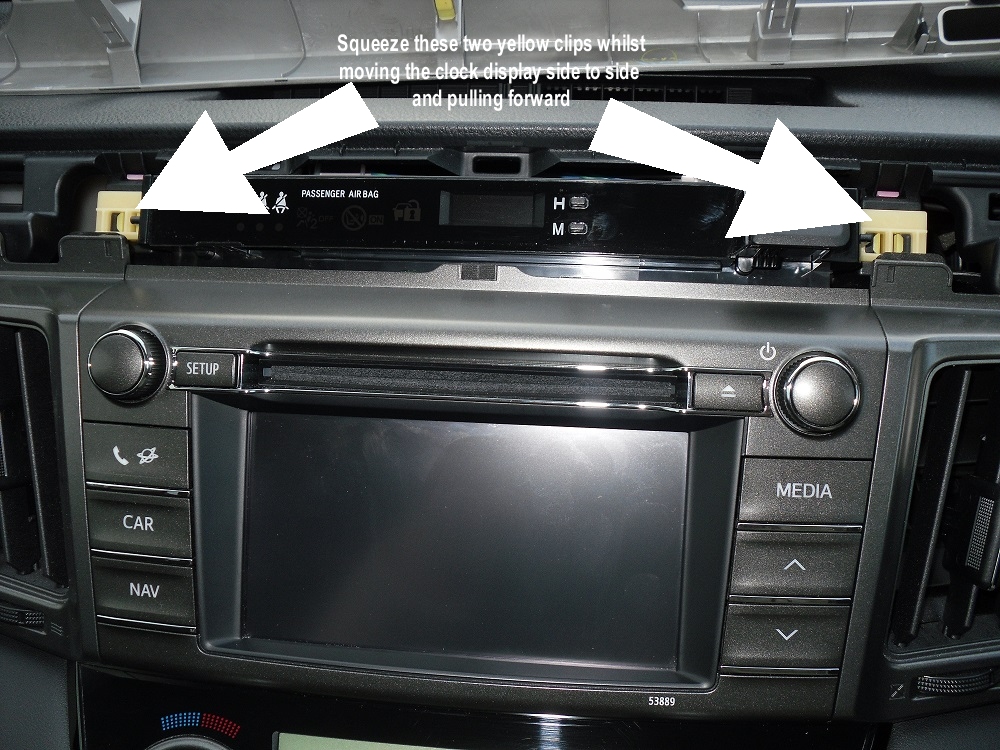

To remove the clock, squeeze the yellow clips side to side and gently pull forward.
Pull out the left then right vents by gently pulling forward on the top of each vent.

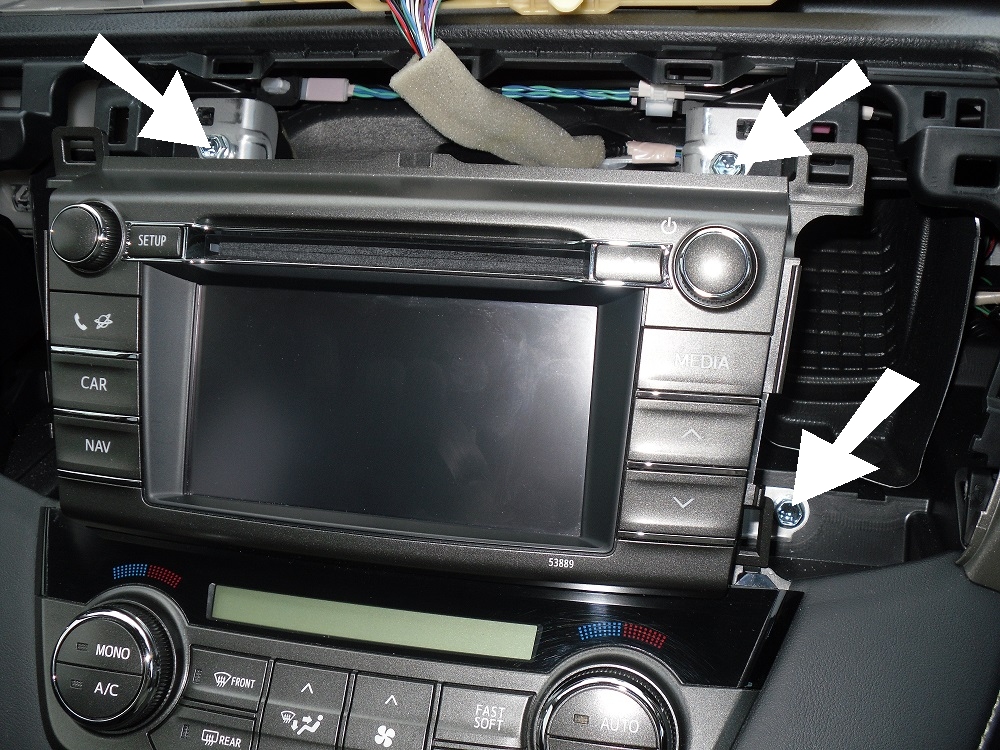

Undo the four HUD retaining bolts (fourth one not shown).

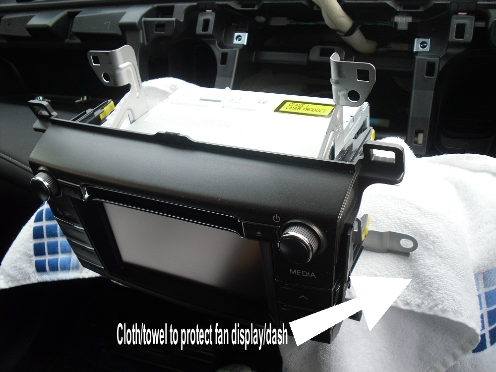

Using both hands on either side of the HUD, lift the unit forward and slowly twist upwards to release from the housing. Before pulling completely out of the dash make sure there’s a cloth/towel covering the temperature/fan screen otherwise this will get badly scratched.
The HUD can be left resting on the cloth/towel or removed/unplugged for easier access.

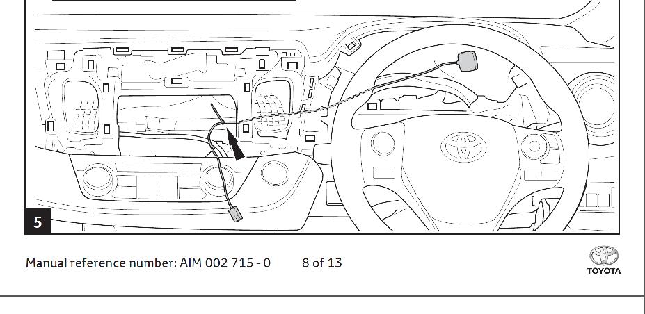

Toyota recommends for best reception the GPS antenna should be located behind the instrumentation clocks and secured to the upper underside of the housing.
Using an automotive trim removal tool (or wooden spatula), gently pry off the clock facia trim. The clock housing is secured by 2 screws and ‘push fit lugs’; undo the screws and by gently pulling the housing forward gain access to the area behind.

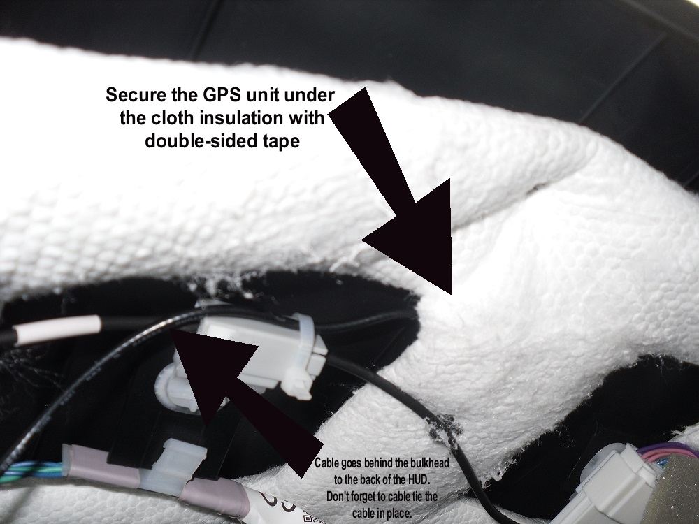

Feed the antenna cable through the area between the back of the HUD and the clock housing. Locate the GPS unit on the underside of the top housing under the cloth insulation. Secure to the roof with double-sided tape.
Pull the GPS antenna cable through the area between the clock facia and the back of the HUD and cable tie in place.

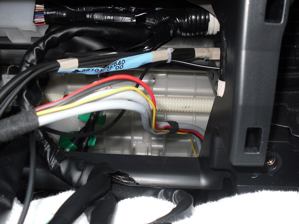

Four cables are supplied, but the only one used is the grey cable, the one with plugs on both ends. Find the end with only one plug on it, the plug that fits into the CS9320A, and feed that down behind the HUD towards the foot pedals, also feed the GPS antenna cable along with it.
Gently pull these through into the footwell but make sure you leave enough grey cable to easily connect to the back of the HUD.

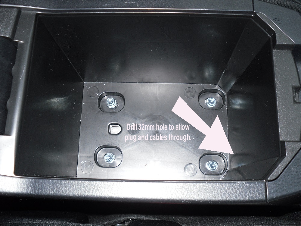

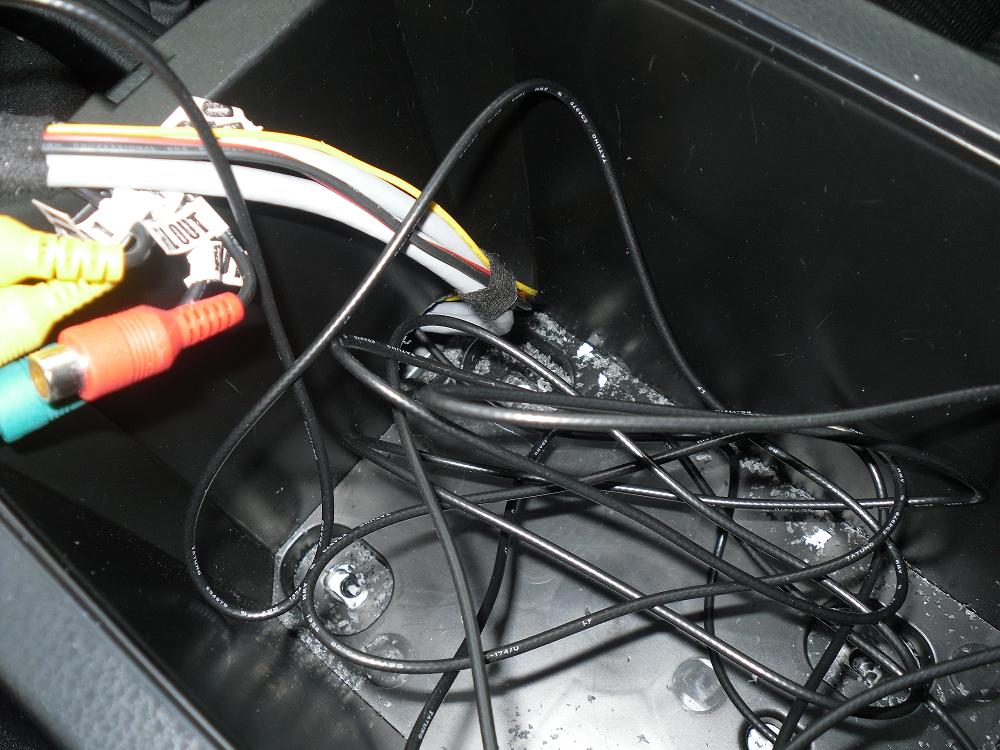

Open up the armrest, and drill a 32mm hole in the front wall, the plastic is very thin and this can be done by hand with a hole-saw.
Feed the grey cable and GPS antenna cable through into the armrest area.
Pull the handbrake cover off and feed the cables along the inside of the centre console, well clear from the handbrake mechanism. When you’re satisfied you have enough cable behind the HUD, feed the remaining through into the armrest area. Secure the cables on the inside of the centre console with Self Adhesive 28mm x 28 mm Cable Tie Assemblies.
