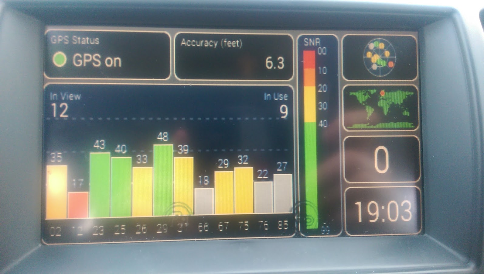

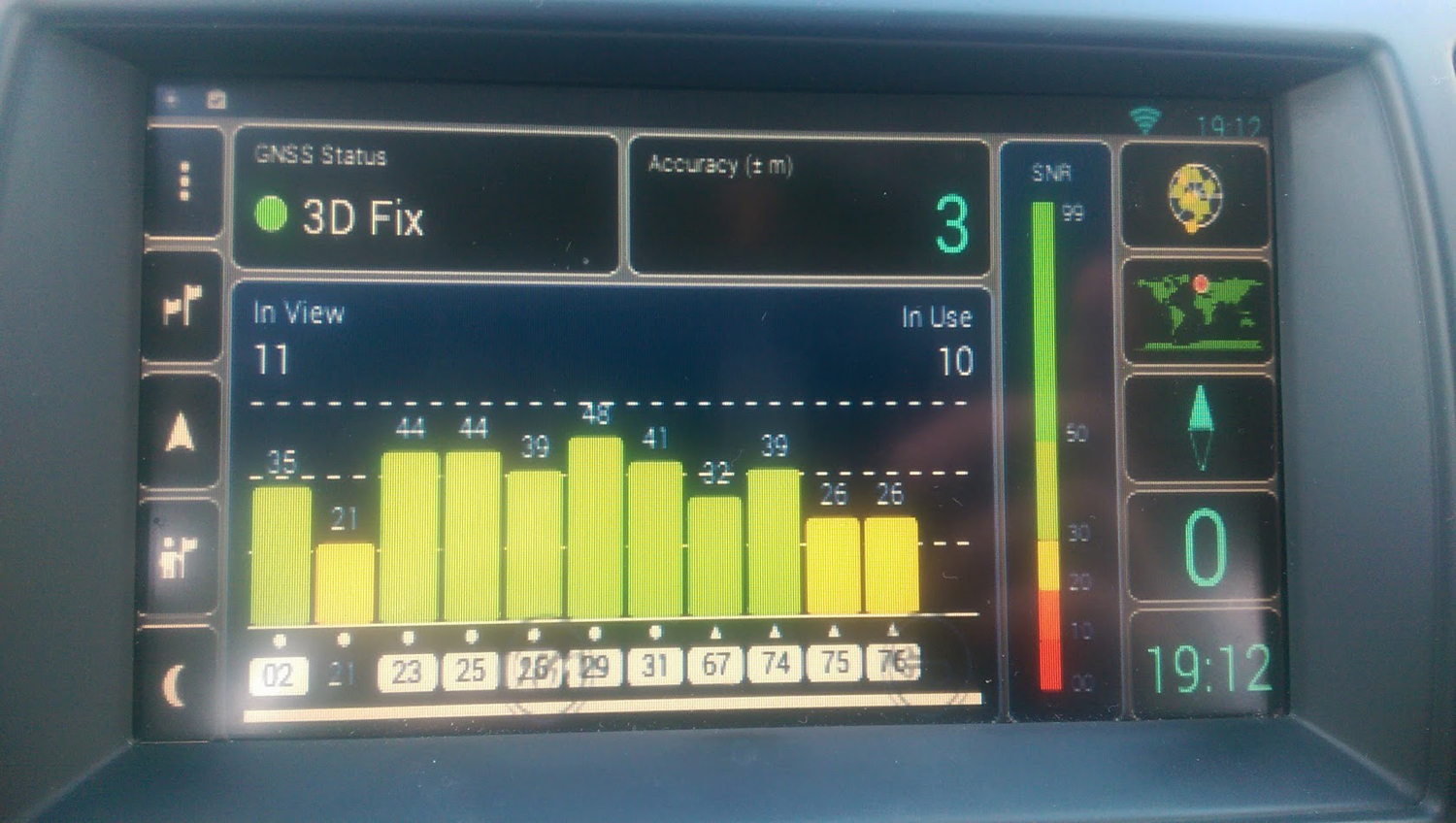

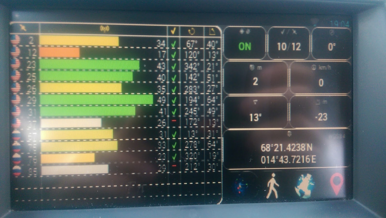

Re: Cs9320 on Subaru Outback 2004 (Kenwood)
Postby Ael » 04 Apr 2017, 20:34
Here is the results:
I don't think at there is something wrong with my GPS antenna, when I drive the navigation program works great.
